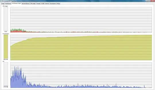

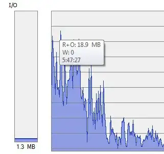

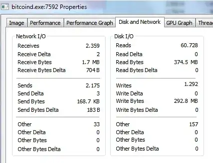

Edit 1: Pictures speak louder than words (as a response to Jannes's comment, so I'm attaching a few performance screenshots from a full node running in Windows that just received a new block and a couple of minutes after that, as well as an analysis of the I/O index:
Verifying incoming block:
Verifying a block
One of the I/O spikes of the block verification at level 3 (default for all clients):
One of the I/O peaks
I/O analysis for the above graphs:
I/O analysis

  • @Jannes I have added a few graphs from a full node to my answer. You say that our concerns about throughput are "nonsense", but I'm afraid numbers speak otherwise. SD's top model maxes at 30 MB/s but take a look at the second graph which is the node receiving a block, I/0 gets as high as 19 MB/s and this is just a random block in bitcoin's still-small blocks. So, in the end, I guess it all comes down to what we actually call a heavy duty I/O task. –  Apr 09 '14 at 15:40
