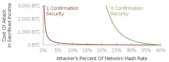

A miner who controls less than half of the hash rate will likely lose a chance at a certain amount of income, but how much depends on how close they get to half of the network hash rate. I created the following image a few months ago to illustrate this:
Cost Of Attack In Forfeit Income
If you look at the BlockChain.info mining pools chart, you see there are several which can make affordable attacks against both once-confirmed and six-confirmed transactions. I suspect all that prevents them from doing so is their reputation in the community.

In the image above, the average cost of a successful attack here is
r * h * b / p(h,b) - r * (b-1)
Where r is the block reward (25 BTC), h is the percentage of network hash rate, b is the number of blocks to create (confirmations plus one), and p() is Satoshi's probability calculator from bitcoin.pdf page 7. r * h * b is the average value of work used per attempt; p(h,b) is the probability of success per attempt; r * (b-1) is the block reward the attacker would've received if they mined honestly.
For reference, the time (average number of blocks elapsed) an attack takes is simply
1 / p(h,b)

  • Great answer :) What does `c` stand for in the last formula? – Doug Peters Nov 17 '14 at 02:03
  • So practically it doesn't cost a thing to a miner to perform such an attack if his hash power is greater than 10% of the total hashing power in the network? – Doug Peters Nov 17 '14 at 02:08
    @DougPeters Whoops `c` == `b` (`c` was for confirmations, but then I realized the formula was confirmations plus one, so I changed it to `b` for blocks). For one conf at 10%, `p(0.10,2) == 0.050978`, so the cost is 48.8 BTC. Cost doesn't actually equal 0 BTC until 50%, but the scale of the chart doesn't allow showing such "small" amounts. – David A. Harding Nov 17 '14 at 02:51
  • Have you tried letting the cost axis be log-scale? –  Nov 17 '14 at 06:58
  • @RickyDemer great idea! However, when I looked at it closer, I found a bug in my formula (it was returning negative results). I fixed the bug and now the regular plot shows the expected long tail (and the numeric output matches the model of 50%==0 cost perfectly). I updated the answer accordingly and I don't think a log axis is needed any more. Thanks for making me pay closer attention! – David A. Harding Nov 17 '14 at 15:39
  • @DavidA.Harding I was wondering if you have a matrix in place presenting `cost of attack` against `hash power`, I would love to take a closer look at the estimated cost for hashing power < 25%. – Doug Peters Nov 18 '14 at 16:37
    @DougPeters here's the [code used to generate the plot](https://github.com/harding/bitcoin.org/blob/mining/img/mining/en-confirmed-double-spend-cost.gnuplot). MIT license. Note, if I had to do it all over again, I'd use something besides bash & bc for the math. :-) – David A. Harding Nov 18 '14 at 17:01
