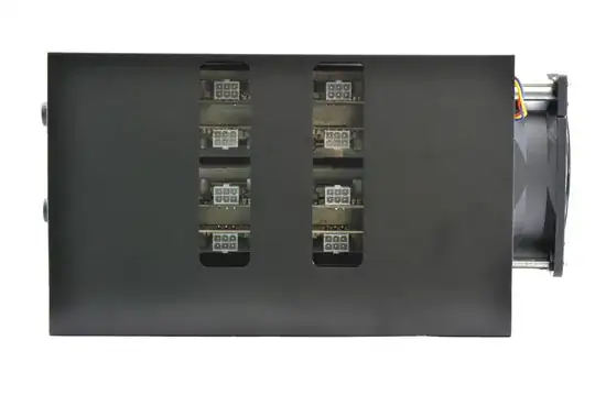

I have an S1 so I am familiar with the basic operation of the Antminers. However, I'm a bit baffled that it has eight PCI-e connectors for power. I've never seen a PSU with eight PCI-e connectors. I'm not sure how I would power this thing effectively if I got one.
I found a great setup guide, but it doesn't go into detail with the power setup.
Here's a picture of how the connectors are set up:
Top of Antminer C1
Here's my questions:
  • The C1 requires that at least four of the PCI-e connectors are used. Which ones then are the important ones?
  • It is recommended that your PSU be at least 800 watts. Is that correct? Is it different if you only power it through four connectors?
  • Is it possible to use two or more PSU's to power the miner? For example, I have tons of 300 to 500 watt PSU's that have at least one PCI-e connector. How might those be useful to me?
  • Do they even make PSU's with eight PCI-e connectors? What is the best solution for a single PSU to power all eight connectors?

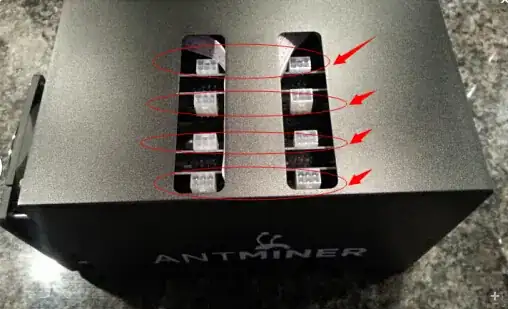

I spoke directly with Bitmain. They said:
The connectors are divided into 4 groups as shown in below screenshot. Connect one of the connectors from each group to the PSU and all 4 hash boards can get power.
C1 which ports to use.
Pretty straightforward. It does indeed need a PSU with only four PCI-e connectors. Personally, I would just pick one slot, left or right, and make sure all the plugs there get a connector. If you are going to overclock the miner I do recommend using the other four connectors to give the boards the extra power they will need.
Regarding using multiple PSU's Bitmain said:
Sure, 2 PSU is OK, make sure the power is enough for the miner.
Also straightforward. The miner uses about 800 watts, plus the fans and the pump for the cooling is maybe 50 watts more. So with this in mind, two 450 watt psu's will be enough to power the miner if you don't overclock. If you do over clock, don't cheap out. Go for a total of 1200 watts in total PSUpower.
In the picture above, the boards run horizontally under the case lid. The power to any board should be by a single PSU. So if your set up is an overclocked miner and two 650 PSU's (meaning you intend to use all eight connectors), I would make sure that the top four connectors in the picture above are all from one PSU while the bottom four are from the other.
Considering that you can use multiple psu's to power the C1, a single PSU solution does not make any sense unless space and available power outlets are a major issues.
