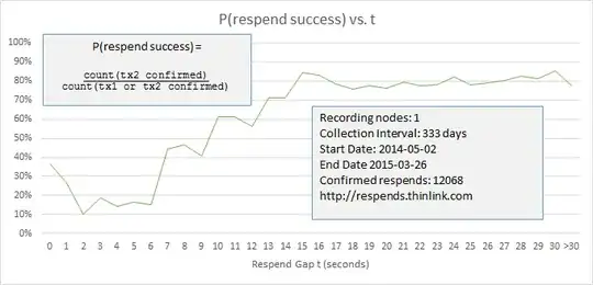

Yes, it is quite possible to successfully double-spend an unconfirmed transaction. Only about 20% of hash power today strictly mines the first transaction seen.
Here is a chart showing the convergence to 80% success when the time gap between the two transactions is 15 seconds or more.
I'll leave it to other resources to give details on how to use the rawtransaction API to do this. Be very careful, as you can easily end up sending much more to fees than you intended.
