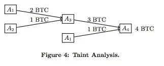

The best (and only) explanation I've found so far appears in the paper Anonymity of Bitcoin Transactions:
The taint analysis works by calculating the percentage of the amount of bitcoins that might origin from another address, thus revealing connections in the transaction graph. In the simplified example in Figure 4, A1 and A3 would have a taint of 75% and A2 a taint of 25%. However, it can only detect direct connections in the graph and does not consider any context information.
This explanation is confusing. Taint is measured between two pseudonyms (addresses). It's not a property of a particular pseudonym. The paper seems to be missing the part that says the taint scores for A1, A2, and A3 are relative to A4. If so, then the scores make sense.
However, it's not clear what would happen for more complex chains of ownership. For example, imagine another pseudonym, A5 that pays A1 5 BTC. What would be the taint score between A5 and A4?

What I'd like to see is the outline of a step-by-step procedure for calculating taint, as done by Blockchain.info. If I had to guess, here's how the procedure would look:
- Find two pseudonyms, S (source) and T (target). Funds flow from S to T.
- Using the block chain, find a chain of ownership Ci from each coin controlled by S to T.
- For each chain of ownership Ci, find the lowest valued coin transfer mi.
- Sum all mi, giving m.
- Sum the value of all outputs received through T, giving s.
- Taint is defined as m/s.
Using this procedure would give a taint score of 50% between A5 and A4 (2 / 4).
Is this correct?
