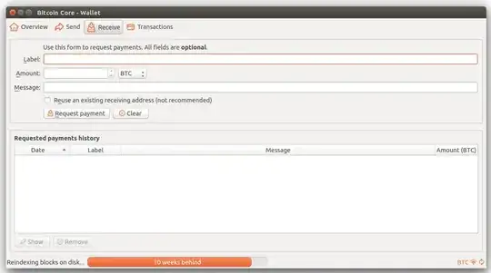

To find out your address, switch to the "Receive" tab:
Receive Tab of Bitcoin Core

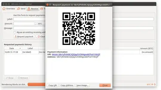

The "Receive" tab will show you a list of all your addresses. The list will be empty at first, so you have to click "Request payment", which will open a new window showing your address: New Address showing in Bitcoin Core
You'll want to copy the alphanumeric string after "Address:" in the last line. To show the address again after closing the window, you can double-click the line in the list, or select it and click the "Show" button in the bottom left corner.
