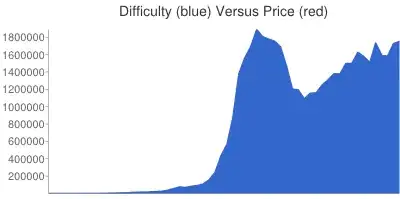

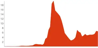

Here you go!
Click the tab at the bottom Difficulty Versus Price for a chart view.
As-of Jul 4, 2012 here's those charts:
