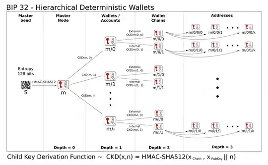

Breadwallet uses BIP39 to generate the 128-bit master seed from the 12-word mnemonic. The master seed is then used to generate a set of wallets/accounts containing chains of addresses, using BIP32.
https://github.com/bitcoin/bips/raw/master/bip-0032/derivation.png
