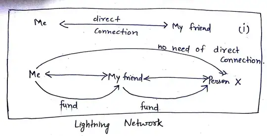

So in their whitepaper who have proposed this idea also in which I can send a transaction to some other person without creating a direct connection to that other person. Le'me explain guys...
Suppose Me and my friend are sending transaction to each other off the blockchain so may be my friend connects to some other person X so in the lightning network, it is possible to send funds from me to person X via my friend. I dont need to have a direct connection to person X. It's really a good way to propagate funds through the network without establishing many direct connections which also could burden the whole lightning network. enter image description here
This is comparable with how the internet works today When i send a packet, it can get routed through many different nodes and the nodes dont really care where the packet is coming from and where it's going, they only care where they should send it next and so the next person may send it somewhere else and then it would finally arrived at final destination. It's similar to how lightning network work if i have a connection to my friend and my friend has a connection to someone else. I could send funds from me to someone else via my friend, my friend wouldnot even know if the funds are intended to go to person X or if person X is supposed to send person Y. If the person X is recipient then transaction is finished and can be broadcasted to the original blockchain so in this way we can do millions of transactions among each other without burdening the entire network and this could really scale the Bitcoin network.
