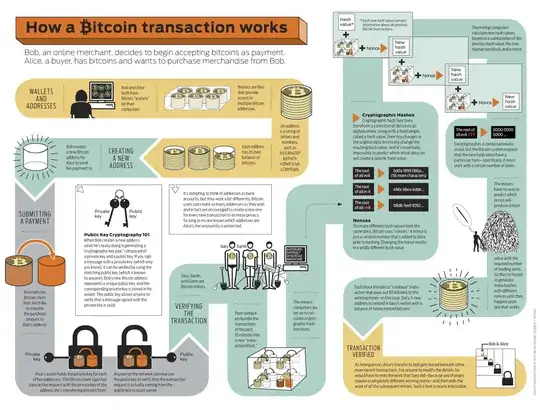

Here's an interactive diagram showing the indivdual steps through the diagram:
