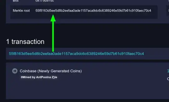

This would indicate an empty block (no transactions). So only the coinbase transaction should be used to construct merkle root. In that case, the merkle root is the coinbase transaction’s hash.
For example block 512,048 was an empty block, and you can see that the coinbase transaction hash and Merkle root are the same:
Example of a block’s details showing that coinbase transaction hash and Merkle root are identical
