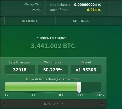

Here is a transaction to SatoshiDice for 0.01 BTC:
But examine the corresponding entry in blockchain.info:
They think this:
Total Input 0.01974 BTC
Total Output 0.01973 BTC
But that is innacurate!
it's acually:
Total Input 0.011 BTC
Total Output 0.010 BTC
Why can't they (blockchain.info) see that while SatoshiDice can?
Is it because the transaction is at this point still unconfirmed?
