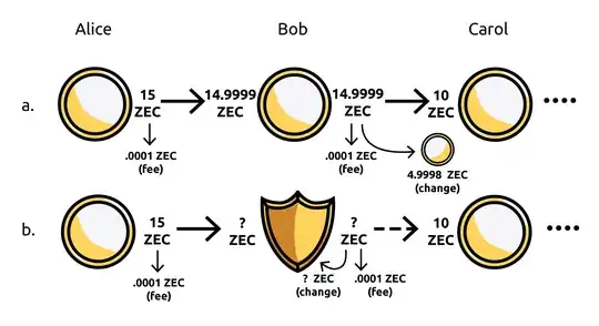

We address this exact question in this blog post (images from which I reproduce below).
Transactions using the Bitcoin-inherited t-addresses are obviously traceable. However, the zero-knowledge property associated with the use of z-addresses means that when you send ZEC to a z-address (creating a "note", the private equivalent of a TXO), and then use that note in a subsequent transaction, the two transactions are not directly linked on the block chain (that is, the second transaction does not contain a prevout field referencing the first one, like would happen with t-addresses).
This means that if you send ZEC from a t-address to a z-address (a "shielding" transaction) and then from the z-address to a different t-address, you end up with transaction chain (b) below:
Shielded addresses can de-link transparent addresses
This "breaks" the link between Alice's and Carol's t-addresses (for this transaction; other transparent payments could still link those addresses, so the same care should be taken as with Bitcoin). Considered more widely, you can imagine "islands" of t-address activity, separated from each other by murky z-address transaction "seas" (see this blog post for related ecosystem discussion).
