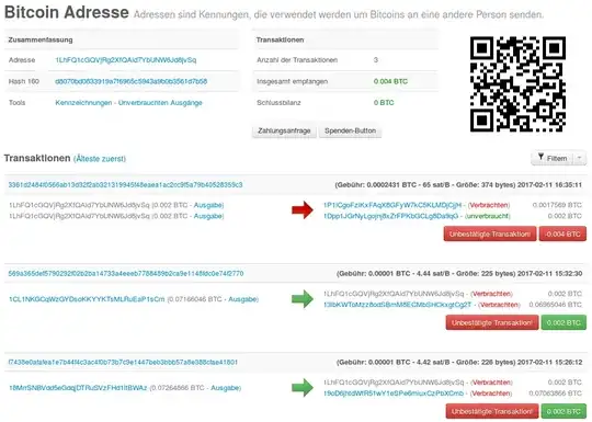

Each node on the network has its own mempool. While they are filled with similar transactions, each may have a different size limit or perhaps even custom rules which transactions to retain.
Unconfirmed inputs
In this particular case you can see (figure 1) that there is a (U) shown in both inputs of the transaction. The (U) means that the inputs are created by a transaction that is still unconfirmed.
Address the inputs come from
In fact, when you look at the address that the two inputs were spent to before (figure 2), you'll see that both were created in transactions that only paid 4.4 satoshis per byte whereas the transaction you linked pays 65 satoshis per byte.
I would surmise that the first two transactions that created the inputs might have not been relayed to or were not kept in the mempool of the other blockexplorers. Then, the transaction that you linked would seem invalid to those blockexplorers, because the referenced inputs are not known to it.

  • Oh, I just see that I made German screenshots. "Unbestätigte Transaktion" means unconfirmed transaction as you probably have guessed. – Murch Feb 11 '17 at 20:59
  • Thanks Murch - I did notice the inputs were unconfirmed but that does not explain why the transaction is not shown on some. – Alex Feb 11 '17 at 21:13
  • May I just add that I am not seeing the transaction on my node, yet the mempool info shows that it's pretty empty: { "size": 12590, "bytes": 26220930, "usage": 52775360, "maxmempool": 300000000, "mempoolminfee": 0.00000000 } Is there anything else I need to do in order for this transaction to be included on my node? – Alex Feb 11 '17 at 21:30
    @Alex: Your node would only get the transaction if one of your peers relays it to you. If none of your peers has it, you'll still not see it even if your node would be permissive enough to show it. – Murch Feb 11 '17 at 21:48
