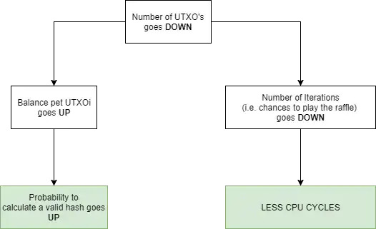

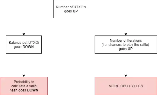

Here are some closely related observations on the topic that might help other newbies like me to understand PoS. I spend a couple of hours trying to put things together and to be honest coming from the PoW background it was quite difficult to really grasp why PoS works the way it does. Especially difficult to understand was how does PoS prevent gaining benefits from having more available CPU power. The answer to this question is quite simple: PoS does NOT benefit from having more hash power since the inputs to the hash functions are quite "static" and therefore the output of the hash function within a given time frame is always the same. To clarify, in PoW the input to the hash function includes a nonce and also the tx's data. These inputs are constantly changing and therefore having more CPU power allows trying more combinations that will hopefully lead to generating a valid block hash. With PoS since all inputs remain the same (only the timestamp changes at regular intervals), having more CPU power does not help the miner because the result of running the hash function with the same inputs will generate the same output hash. The only thing that can be done to increase the impact of CPU is to increase the number of UTXO's that a wallet owns by splitting larger UTXO denominations into smaller ones. However, this will lead to a higher difficulty to generate a valid hash. Here are two diagrams that I drew that represent the correlation between the number of UTXO's per wallet, the individual balance of each UTXO, the number of "mining" iterations and consequently the CPU cycles.
Diagram 1 (Increasing the number of UTXO's leads to slower probability for generating a valid block hash):
Diagram 2 (Keeping the number of UTXO's small but with higher denominations per single UTXO increases the probability for generating a valid block hash):
Both diagrams represent the same correlation between the number of UTXO's per wallet and the probability to calculate a valid hash. In Proof-of-Stake the idea is to use the wallet balance as a variable in the calculation of the block difficulty. An example formula for making this calculation could be the one below: enter image description here
Using that formula, the correlations presented in Diagrams 1 and 2 could be interpreted as follows:
If the validator (miner) tries to split his UTXO's into smaller denominations and thus increasing the number of UTXO's that the wallet has, the difficulty of calculating a new hash increases. The reason for this is that the balance of each individual UTXO(i) will be smaller, thus balance(UTXO(i)) / difficulty will be a really small number and it will be harder to generate a valid hash.
