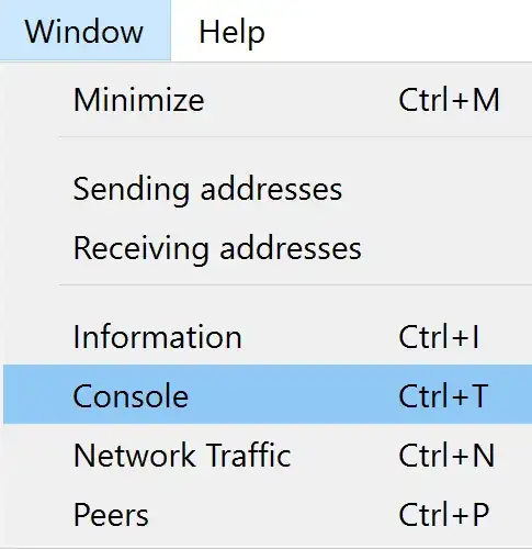

Edit to the @cdecker answer. I had the same problem using Bitcoin Core v22.0.0. My transaction wasn't send correctly because my proxy didn't work probably, but the transaction was already displayed in my wallet but never got sent to the bitcoin network. Even after fixing the network problem Bitcoin Core didn't resend the transaction.
If you're using the client version you can open the Console on the top and type the following without the bitcoin-cli to resend your transaction.
getrawtransaction <txid>
sendrawtransaction <rawtx>
