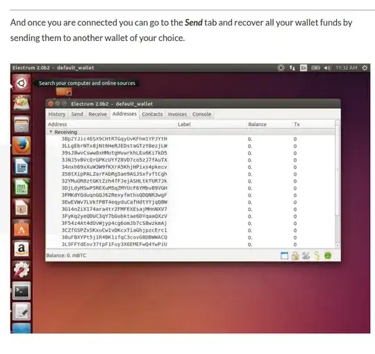

Step 2: Follow the Recovery Guide that they mentioned to recover some Bitcoin from a 2of3 account to an Electrum wallet, all except for the last step, "send to another wallet".
https://blog.greenaddress.it/2of3recovery/
If I understood this correctly from a quick read, it looks like it imports seeds and generates appropriate private keys directly, rather than involving the Bitcoin network in any transaction.
Step 3: Verify that you have the same private keys in the Electrum wallet as exist in the GreenAddress wallet.
You should see your balances in an interface like this:
