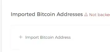

Sign up and after logging in, go to settings. Then in settings, you will see addresses as shown below:
Then click on Import Bitcoin Address as shown:

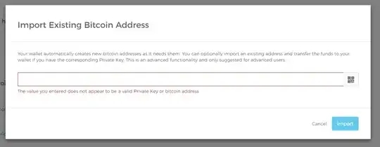

Then add your private key as it is in the form as shown:
Click import, and you will be able to use your BTC again.

    Hum, is it really safe to give my private key on an online website? – Basj Nov 03 '17 at 10:42
  • @Basj No. By using an online wallet you are trusting whoever is managing the wallet. You can split your BCH with a local light wallet. Just be sure to transfer your BTC to a new wallet, as those keys aren't safe to re-use (you will have to expose them to your BCH wallet when you sweep in funds). – Shadow503 Nov 03 '17 at 13:55
  • @Shadow503 ok so I prefer not to use any web solution. How would you do it (selling the BCH that you automatically have to BTC)? – Basj Nov 03 '17 at 14:00
  • @Basj I misread your question - I thought you just wanted to split them. In theory, you could craft something called an atomic swap that would allow you to swap cryptos with someone in a trustless manner. Unfortunately, the transactions have to be manually crafted, and the infrastructure for finding a buyer just isn't there. For now, an exchange is necessary for crypto swapping. Revisiting your original question, as long as you move your BTC out of the wallet containing those private keys first, asterisk's solution has minimal risk. You still have to trust blockchain.info though. – Shadow503 Nov 03 '17 at 14:06
  • Not sure to understand @Shadow503, could you post a full answer explaining these details? (what do you call "split" them? I just want to sell the BCH into BTC and no longer have BCH). – Basj Nov 03 '17 at 14:08
    Basj, please re-read my answer. I have specifically said "Transfer your BTC from that address/es to any other new address (just to be sure)" Even if you don't use a web solution, you need to share your private key with any other software, which may/maynot be compromised. So, I recommend you to transfer your fund before getting BTC and as @Shadow503 said, don't re-use those BTC addresses. – remedcu Nov 03 '17 at 14:08
  • asterisk, so are you saying I should transfer my BTC to another address first (does this involve transaction fee?) with standard Bitcoin (using Electrum). And then I use blockchain.info with the old address, right? – Basj Nov 03 '17 at 14:20
  • @Basj Exactly. This way you have no way to lose your BTC. As well, you will have total access to your BCH using blockchain.info :) – remedcu Nov 03 '17 at 14:28
  • @asterisk So I have to transfer BTC from my old addresses to new addresses, right? Will this involve fees? – Basj Nov 03 '17 at 14:29
    Yes, it will incur normal transfer fees, but that is much better than the risk. – remedcu Nov 03 '17 at 14:37
