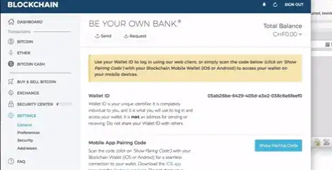

Blockchian.info is not really qualified to provide Bitcoin API's for business, 20 empty addresses are really cool and enough as a personal wallet but for business, it's not.
I suggest you find an alternative or use some payment gateways, or you can do the following but it's not really recommended.
  • Increase 20 address limit by getting more than blockchain wallet, When some user create an address check gap if it's over 18 change the xPub to the next xpub and go on.
  • 15 min time limit, if the user didn't pay within 15 min, give it to another user. Note: You don't have to wait for confirmations. Once you receive a transaction mark those addresses so you don't give them to another user.
  • Before you reach address number 20, pay a small amount automatically to that address so you get another 20 address.

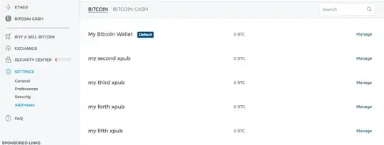

You can't create an xpub Programmatically (using blockchain.info api), but a new wallet
https://blockchain.info/api/create_wallet
You don't really want to do that, you can create like 5 xpub's keys and store them in your database, and just sweep between them.
blockchain.info
Settings --> Addresses --> + ADD. Click To create a new xpub key.
Manage --> Show xPub. To get your extended public key (xpub).

it's simple if you use multi xpubs, because there is no limit to generate wallet inside and by creating multi wallets inside you will be able to get multiple xpubs and then you can still set them as if one reach it's gap limit use another one. you can set unlimited xpub like this.
This way is safe for dynamically generating address; - notify the user to pay only withing 24 hours - reserve the address for the user for at least 1 day (2 days recommended) - run a cron job to reset the address after the 1 or 2 days
