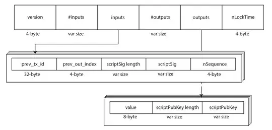

There are quite a lot of things going on there, so let's break it down bit by bit.
Transaction structure
A transaction can be seen as a collection of inputs and outputs. Inputs refer to previously created UTXOs, while outputs generate new ones. Therefore, when creating a transaction each input spends a UTXO and each outputs creates one.
Outputs structure
Outputs is what contains the so called locking script, or how it is normally referred in a transaction, the scriptPubKey. Such an script contains the condition required to spend such a UTXO.
Inputs structure
Inputs contain references to previously created UTXOs (through the prev_tx_id and prev_out_index fields). Moreover, inputs contain the so called unlocking scripts, or how they are normally referred, scriptSig. Such scripts require the proof of fulfilment of the conditions specified in the UTXO each input is trying to redeem.
