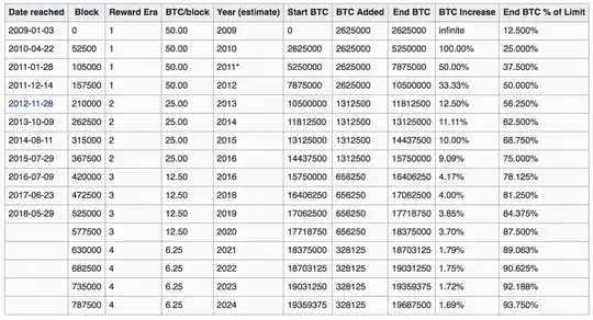

There is a fixed rate for how many bitcoins are mined each block. The block reward halves every 210,000 blocks, see Controlled Supply.
Here is a short term bitcoin distribution projection from the Bitcoin Wiki:
To calculate the total coins for a given block, try:

Thanks for you answer, I'm looking for the (pseudo) code that would generate this array. – franck Aug 10 '18 at 07:02
Just added some code and a project that might be helpful – JBaczuk Aug 10 '18 at 13:12
