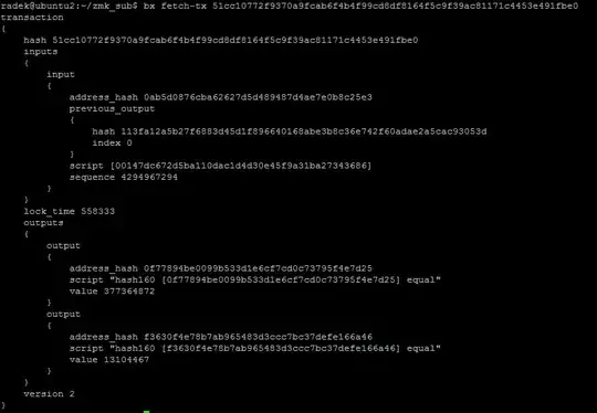

I'm using private libbitcoin server and libbitcoin explorer. When I use bx fetxh-transaction, it returns something like:
I'm trying to figure out, how to get right address from address_hash. When I use bx base58check-encode for input address_hash without version (or -v 0) it returns:
When I use bx base58check-encode -v 5 it returns:
Check by blockexplorer shows the second way is right. My question is: How to determine base58check-encode version to generate right address?

  • Thank you for response. Bx explorer returns address_hash as shown above, but my problem is how to correct determine version from bx response. Other blockexplorers like blockchain.info or bitpay insight shows right address, so there is a way to determine the right version. Miss I anything? – Ramirez Jan 14 '19 at 09:47
  • You mean how to decode the version from an address, such as 32feVAD9Haq1CtfT6JCLTt4L5qef3UnVpY? Try bx address-decode 32feVAD9Haq1CtfT6JCLTt4L5qef3UnVpY – James C. Jan 14 '19 at 09:50
  • No. I want to use bx fetch-tx result to generate address. It returns address_hash and bx base58check-encode returns address. But only with right version choosen it leads to the right address. My problem is to determine the right version. – Ramirez Jan 14 '19 at 09:55
  • I see. You have to examine the output scripts when you fetch the tx. The output script pattern (P2SH or P2PKH etc.) will tell you what version is required (05 or 00 etc.). BX doesn't recognise script patterns for you. Libbitcoin-System has internal methods which check for standard output script patterns, if you want to look into the Libbitcoin C++ library. – James C. Jan 14 '19 at 10:12
