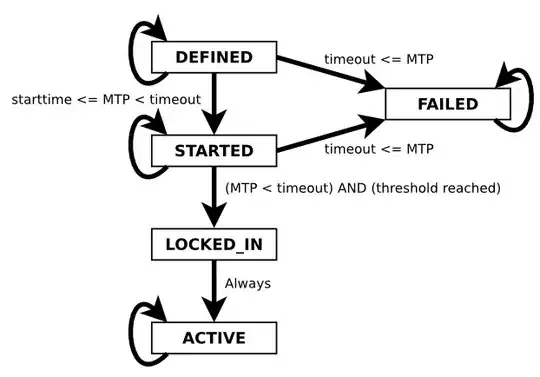

How is the soft fork signaled?
Initially, soft forks used to be signalled with the block version number, but due to its many limitations BIP-9 (read full documentation here) is used. In BIP-9, the block version number is interpreted as bit field instead of an integer (we currently have 29 bits where we can signal this). BIP-9 also sets a maximum time for signaling and activation. This way miners don’t need to signal forever. If a proposal is not activated within the TIMEOUT period (defined in the proposal), the proposal is considered rejected. The proposal may be resubmitted for signaling with a different bit, renewing the activation period.
How is the consensus change enforced?
BIP-9 counts activation signaling in whole intervals based on the difficulty retarget period of 2016 blocks. For every retarget period, if the sum of blocks signaling for a proposal exceeds 95% (1916 of 2016), the proposal will be activated one retarget period later. Proposals start in the DEFINED state, once their parameters are known (defined) in the bitcoin software. For blocks with Median Time Past (MTP) after the start time, the proposal state transitions to STARTED. If the voting threshold is exceeded within a retarget period and the timeout has not been exceeded, the proposal state transitions to LOCKED_IN. One retarget period later, the proposal becomes ACTIVE. Proposals remain in the ACTIVE state perpetually once they reach that state. If the timeout elapses before the voting threshold has been reached, the proposal state changes to FAILED, indicating a rejected proposal. FAILED proposals remain in that state perpetually. Below is a diagram from Mastering Bitcoin book. BIP-9 State Transition Diagram
