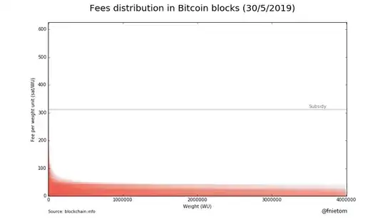

There a are a few things to take into account when we consider the probabilities of a rollback attack (a posteriori reorg destroying net value) to be successful:
  1. If the reorg is shallower than 100 blocks (COINBASE_MATURITY), the attacker can minimize the amount of direct victims. But if we are talking about a deeper one, not only the payments he wants to revert may have been spent, mixed with additional inputs and all those coins owned by other innocent people, this would also apply to coinbases earned by honest miners. The longer it takes to perform the reorg, the higher the amount of victims and their value at stake.

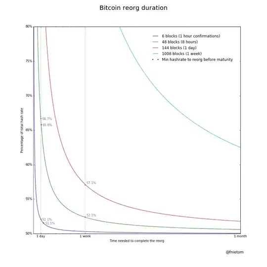

  2. The attack may take a long time. The fraction of miners participating (via direct control or bribes) and the amount of blocks to revert will determine how long.
    For example, to revert 6 blocks (1 hour worth of confirmations) before coinbases start maturing, the attacker will need to get immediate control over 51.5% of the hashing power. If he falls short of that percentage or requires more time to convince some of the miners, it will take him over 33 hours and reverting more than 100 blocks in total, so rewards from the first blocks may have been mixed and spent already, tainting UTXOs worth much more.

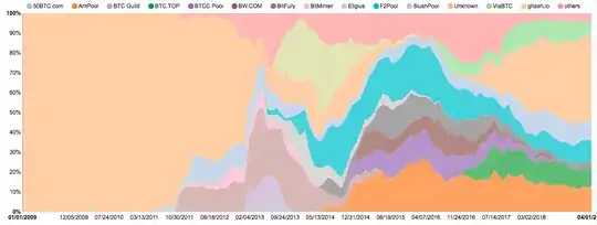

  4. The more independent miners, the more difficult it will be for anybody to coordinate them and try to 51% attack the network with existing mining capacity. Currently over 40% and growing.
