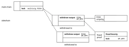

she submits a SPV proof to S2.
The way this worked in the first implementation of the sidechains paper by the same authors (called Elements Alpha, now elements) is as follows: The genesis block of the sidechain S2 creates a bunch of outputs with a new opcode OP_WPV that can be spent with an SPV proof showing that some amount on S1 has been "sent to a certain-locked output". Note that S2 follows the UTXO model of Bitcoin and there's no global state that OP_WPV could look up. That means that it's possible to provide exactly the same SPV proof to another OP_WPV locked output and effectively transfer your coins from S1 twice. That's why there needs to be a contest period where honest nodes have the opportunity to provide a fraud proof and lock the coins back into the OP_WPV.
fraud proof
Now if there needs to be a contest period anyway, we can make the confirmation period shorter than what we would assume to be secure against reorgs. Instead, the contest period is used to provide a window for reorganization proofs.
You can find more information about how this mechanism worked in this article: https://github.com/jonasnick/elementsproject.github.io/blob/master/source/_posts/The-Federated-Peg-in-Elements-Alpha.md.
