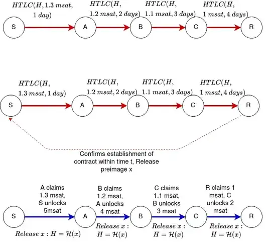

In HTLC, after all the parties have locked their funds in the contract, claiming payment happens in a reverse way, starting with the receiver who reveals the preimage of the corresponding payment hash.
What would be the problem if it had started with the sender? After the receiver confirms receipt of the contract, it sends an acknowledgment to sender. Sender releases preimage, timelock set in increasing order across the path, contract initiated by sender having the least locktime. Receiver is the last node to settle the payment.
For reference, I am adding a picture so that one can visualize what I am trying to say.

I think you have answered your question yourself. If all nodes would behave honestly and in good faith your process would work. But in that case we would not need to go through the hustle of setting up htlcs to begin with but we could just forward money by changing the balances in each channel. The whole point of using htlcs is to make the payment process atomic and prevent nodes along the path from stealing funds.
Other than that I do not see any additional flaws.

In HTLC, after all the parties have locked their funds in the contract, claiming payment happens in a reverse way, starting with the receiver who reveals the preimage of the corresponding payment hash. What will be the problem if it had started with the sender?
Firstly the sender has technically nothing to claim, secondly the receiver is the only one able to reveal the preimage in the first place.
Do you mean the receiver would then hand the preimage to the sender ? This adds even more interactivity (if not using the Lightning Network itself to transfer the information) and also drops (partially ?) the Proof Of Payment.
I didn't think too hard about it but it may also open up a lot of other issues, what would be the rationale for doing so ?

  • Yes without the interaction, sender will not be able to figure out whether receiver has accepted the incoming contract for claiming payment or not. Had it not been the case, then sender would have started the transfer of fund but there might be parties in between who don't forward the payment. Hence for the atomicity of payment, this step is needed. I am thinking about a payment protocol with some incentivization mechanism and for that, a reverse payment looks feasible rather than settling payment from receiver. – Subhra Mazumdar May 23 '20 at 15:57
