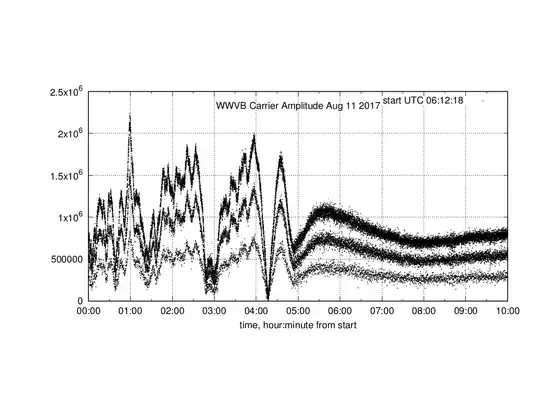

WWVB propagation does vary in amplitude. And its BPSK phase modulation makes it a bit tricky to lock to. But if you narrow the bandwidth enough, signal is most always above the noise.
Here's an example plot of WWVB amplitude in a fringe area similar to Boston...left half is night-time while right half is day-time. Each sample is exactly one second long. Bandwidth of this receiver is about one hertz.
You see three different amplitude samples, because the integrated amplitude each second can take on three different digital codes (low, high, or sync).
The vertical amplitude scale is arbitrary, proportional to volts, not watts. Antenna was a 0.7 m loop at ground level resonated to 60 kHz. A ferrite rod antenna produces similar results.wwvb carrier amplitude
