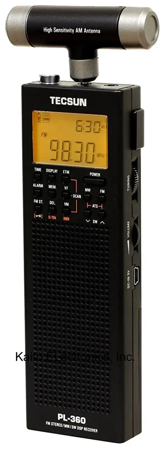

Now, your device of choice doesn't come with any rating for maximum input power – which isn't surprising, since its been designed with the antenna you see on the pictures in mind, and it probably works unless you directly couple that antenna into a transmitting circuit:
Tecsun
"AM Antenna" is of course a mislabeling. Antennas generally don't care about the modulation used, what is meant is "long-, medium- and shortwave antenna"; the shape suggests (as does its purpose) it's a ferrite core antenna.
You won't get happy when you attach your long wire antenna the same way you attach this ferrite core antenna: These antennas are high-impedance and very selective. Hence, the port where it's plugged in will also be very high impedance, and that will make it practically impossible for the receiver to get significant amounts of power from your long wire antenna, which has low impedance, which needs to be "sunk" into a matching-impedance receiver.
