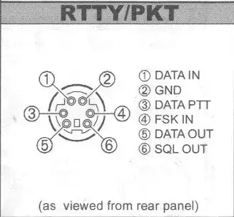

DATA connector has these pins:

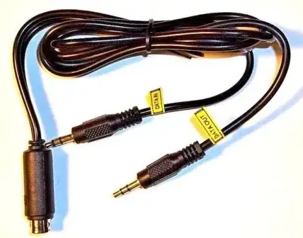

And the cable looks like this:
  • DATA connector is attached to the computer's audio in/out jacks
  • Computer can record receive-audio fine.

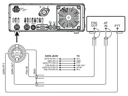

The Operator's Manual shows an external TNC for RTTY and PSK, wired like this:
So I admit to being a bit confused as I thought the data cable would be all that would be necessary to use software digital modes from the laptop. Now I see that the PTT line is n/c.

The "data" cable you picture provides only audio in and out. Some other device, like a TNC or a computer, must provide the modulation and demodulation to provide any data capability.
Additionally, the cable picture does not expose the PTT connection on the data port, so with that cable alone there's no way for the computer to key the transmitter.
However, you do say you have a "USB-to-DB9 cable" installed. Yaesu calls this the CAT port. You can use this connection to key the transmitter, as well as control most other functions of the radio such as frequency, mode, and so on.
It sounds like all you need to do is configure your CW keyer software to use the CAT interface to control the radio.
How this is done depends on the software, but any reasonably modern software like fldigi or Ham Radio Deluxe does have the capability. Look through the setup menus and you should be able to find it.
