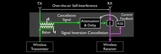

One method to achieve this is to invert, attenuate, and delay the transmitted signal and feed it back into the receiver. This will cancel out most of the power of the transmission, so the input end of the receiver isn't swamped by the RF from the transmitter.
http://sing.stanford.edu/fullduplex/
This will have to be actively managed, but the report suggests that it works for ultrawide bandwidth signals.
