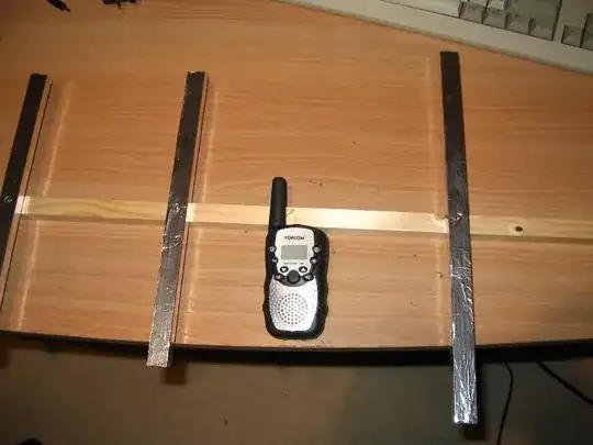

Although the following picture is technically breaking the rules (as you increase EIRP) you will get a more directional performance out of your handset without opening and tampering:
enter image description here (source: http://on3jt.byze.be/build-a-lowcost-yagi-antenna-for-pmr446)
