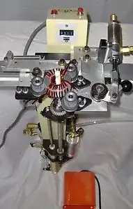

There are machines that wind toroids but their cost is generally out of reach for the hobbyist. Here is an example from spwindustrial.com:
A few years ago I built a solid state, 7 band, linear amplifier. Halfway through winding all the toroids for the bandpass filters, I nearly bought such a machine!

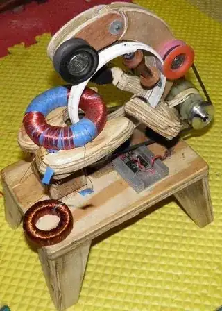

There is also a maker movement to create homemade toroid winding machines such as this one from http://www.instructables.com/id/Simple-Toroidal-Coil-Winder/:
