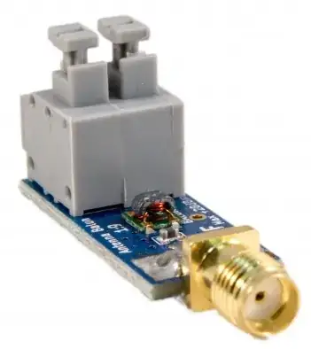

Here is the most convenient method I have found for twinlead. These are very inexpensive.
No soldering required.
(For a long wire, connect the antenna to the right-hand spring connector as shown in this orientation, then a shorter stub to ground to the left-hand spring connector)

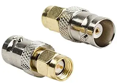

To connect to BNC there are adapters such as this available for a reasonable price:
