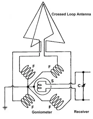

At first blush you could achieve this with two tuned magnetic loops at right angles to each other (visualize an egg-beater) and a 1/2 wave vertical for the omnidirectional part.
Of course, someone has thought of this crossed loop arrangement before, in 1907 Bellini and Tosi invented the Bellini-Tosi Goniometer:
A coil is rotated inside an electrical field fed from the N-S and E-W antenna signal components such finding the angle of maximum signal. The antenna can be either be a circular array of 1/4 wave verticals or a Crossed-Loop Antenna:
Systems based on this principal were the basis of the first radio navigation systems for aircraft until replaced by radar following WWII.
Back to the original question though, I think the loops would have to be tuned fairly precisely and high-Q loops are rather narrow in bandwidth so you'll have to pick your operating frequencies with care. But I don't see any obvious reason why it couldn't be done.

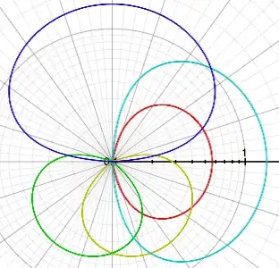

A graph might help:
polar plot of functions
This shows the response of the three possible pairings. $f_1$ is red, $f_2$ is yellow, and $f_3$ is green. $h_{1a}$ is cyan, and $h_{1b}$ is blue. Only the positive lobes are shown to make the polarity of the signals easier to see.
The 0th order response, the omnidirectional one, is easy: it's simply the average of the three antennas. This is equivalent to a vertical antenna in the middle of the triangle array. This serves to sense the phase of the signal so we can know if it is in the positive or negative lobe of the 1st harmonics. Without it, there would be a 180 degree direction ambiguity in any measurements.
