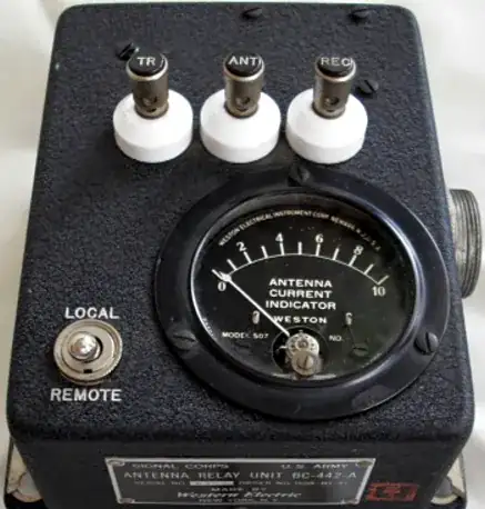

  1. Mostly, they used RF Ammeters in series with the antenna. The first ones were hot-wire ammeters which were completely mechanical devices. One end of a thin nichrome wire (or other wire of sufficiently high resistance) inside the meter was coupled directly to the pointer shaft (often wrapped around it); the other end was anchored to the meter case. As the wire got warm and expanded due to the antenna current flowing through it, the spring-loaded pointer shaft rotated clockwise.
    Later, an improved RF ammeter design --that featured slightly faster response and improved RF isolation-- used an external thermocouple which sensed the temperature of a high-resistance wire in series with the antenna. The thermocouple was connected to a millivoltmeter (or milliammeter?) with the scale calibrated in amperes. The more current, the hotter the wire and the thermocouple junction. The higher the junction voltage of the thermocouple, the higher the meter reading.

That's how I tuned my homebrew transmitters for max back in the late '60s and '70s. My RF ammeter was a WWII military surplus unit (pictured below), and measured from 0-10 amps. The meter was fed from a thermocouple unit inside the case.
WWII surplus BC-442-A RF ammeter

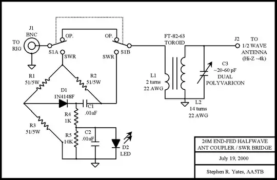

I can't say it was used historically, both because 50 ohm loads were not the norm they are today, and LEDs did not exist, or even solid state diodes if you go back far enough, but one way to tune an antenna without an SWR meter is given by example in AA5TB's tuner:
R1, R2, and R3 form a Wheatstone bridge, with the antenna making the fourth leg of the bridge. The LED is dimmest when the antenna impedance is near 50 ohms. I've explained the operation of the circuit in more detail in another answer.
This is interesting in that there's no directional coupler, so it doesn't measure forward and reverse power like a typical SWR bridge. Instead it just measures how close you are to 50 ohms (or any other impedance, if you swap out the resistors) which accomplishes the same objective.

    I think he means the LED is dimmest when the antenna is nearest 50 ohms, because then the brdige would be balanced, D1 would not have a signal to rectify and so would not drive the LED. – Paul Jul 01 '19 at 20:08
    right you are, thanks for the correction – Phil Frost - W8II Jul 01 '19 at 23:26
