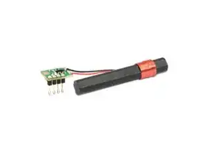

Since OP requires MCU, doesn't have to be extremely sensitive or selective and the 'local' transmitter, one suggestion is
  1. Use Arduino (Atmel) to control DDS chip to generate 25MHz + - 77.5KHz
  2. Use mixer circuit taken out of Hamitup or similar. Simple transitor, FET, MosFet or diode also ok (for local transmitter)
  3. The 25MHz signal, now shifted to 77.5KHz, can be feed to a 'standard DCF77 receiver' (below and also many design on web) which presumably have some degree of band pass filtering in the front end.
  4. This setup does not have good image rejection. It will work under specific condition OP requires, local transmitter.
Info DDS and driver here DDS2 DDS info
Alternately, to above DDS with Arduino, another suggestion is the ProgRock and (manual here) which is an interesting solder kit and also fulfills OP's Atmel chip requirement. It uses another DDS chip, Si5351A and outputs square wave instead of sine wave as above chip. Square wave has less favorable spurious response but no problem under OP specified conditions. LPF can be added to make it sine wave.
As OP mentioned building stuff, yet another alternative to consider is to get a HamitUp, removes the oscillator and replace with signal, with suitable level adjustment (no need to be very accurate), from either of the two DDS plan.
After building it, both DDS become a signal generator that you can use it for other task. Like WSPR and a few other digimode transmitter, just change software. Tie 2 balloons and flew around the Earth S11
Happy HAM / DIY. Tens of Euro/USD/Stg/etc., in hands of knowledgeable people, can go far. Hope it helps.
Here is plan for a standard DCF receiver with Arduino decode software. Hardware ant with amplifier module. Signal from the mixer can be coupled to the antenna rod by 3 turns winding at the far end (away from existing coil) of the ferrite rod
