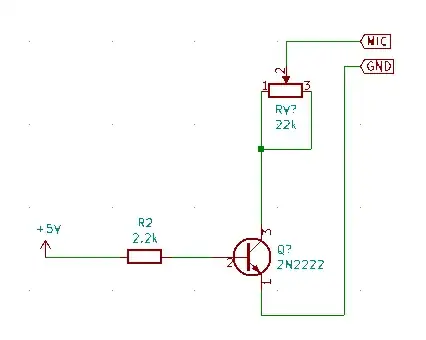

I figured out a way to be able to trigger the PTT properly using a transistor. It requires a high value resistor. I used a potentiometer to find the correct position.
potentiometer with transistor

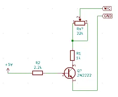

Based on a feedback I had, I recommend this update (adding a resistor between the potentiometer and the transistor) which is ensuring the collector to have always a resistance for the collector.
potentiometer with transistor and new resistor
