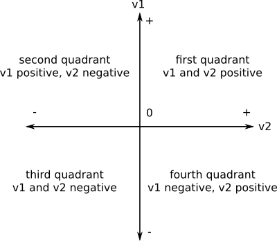

We could draw a graph of the two input voltages $v_1$ and $v_2$, and it would look like this:
Any possible input to the mixer at an instant is a point somewhere on this graph. If both voltages are zero, that's the point in the middle. As $v_1$ increases, we go up. As $v_2$ increases, we go right.

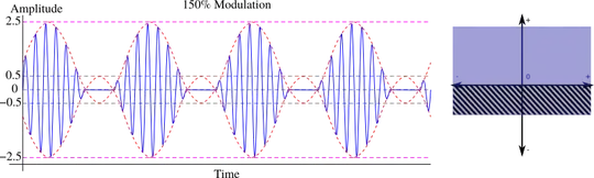

Let's consider simple amplitude modulation where $v_1$ is the baseband signal, and $v_2$ is the carrier, at 50%, 100%, and 150% modulation. On the left for each case is the ideal mixer output, and on the right a shaded region showing the region in which the inputs will fall on the graph under these conditions.
At 50% modulation, the baseband signal is always significantly more than zero, so only the upper parts of the first and second quadrant are encountered.
At 100% modulation, the baseband signal touches zero but is never negative, so the first and second quadrant are used all the way down to the origin.
At 150% modulation, the baseband signal goes negative, which means an inversion of the output as operation enters the 3rd and 4th quadrants.
A mixer which can operate in all four quadrants, producing the inverted signal as would be expected of an "ideal" mixer where $v_\text{out} = v_1 \times v_2$, is a balanced modulator.
Some mixers can't produce $v_\text{out} = v_1 \times v_2$ in all four quadrants. They may clip the output rather than inverting it when crossing into the 3rd and 4th quadrants:
Such mixers are not balanced modulators.
