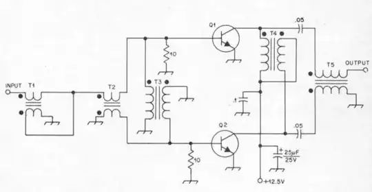

Firstly, feel free to move this to Electronics SE if it's not on-topic, but it's strongly related to ham radio and RF circuitry.
Reading Hayward's classic "Solid State Design for the Radio Amateur" and looking for inspiration, I came across the following push-pull PA design that I didn't quite understand (Chapter 4, Pg 62).
I don't have a problem with T1 and T2, it's T3 and T4 I'm struggling with. T1 is a straightforward 4:1 impedance transformer; it doubles the current at the output and so "looking back into" T1 the source appears to have 4 times less impedance. No problems there. T2 has the dotted secondary tied to ground and so the current flowing into the dot (transformer action) leaves the other end of the secondary negative. Now we have anti-phase signals of equal amplitude at the transistor bases, turning each transistor on and off alternately. Again no problems there, it's straightforward push-pull action.

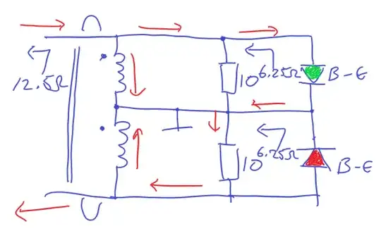

But here's where the wheels fall off for me! What's the purpose of T3 (and T4 which I believe has a similar purpose)? Here's what the author says: "The third core [in the input section of the amplifier] ensures that the load presented to T2 is balanced. Each transistor sees a driving impedance of 6.25 ohms". I've included a hand-sketched re-arrangment of the circuit to help me understand and I can sort of see how the current produced by the full potential of the balanced signal (anti-phase peak-to-peak) is driven through one or other transistor bases. Does this account for the halving of impedance "seen" by each transistor as the author says? But then, wouldn't this happen anyway, without T3??

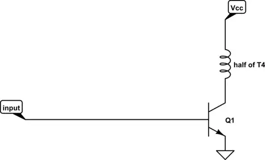

T4 is just this idea:

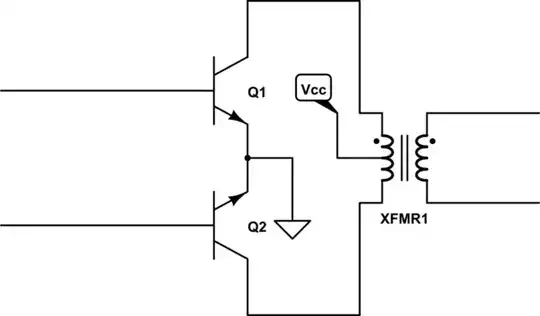

Sometimes it's done this way:
schematic
simulate this circuit
The primary of XFMR1 is equivalent to T4 from the question.
Since T4 provides the collector load for the transistors, it's a factor in voltage gain. For a differential-mode input, the collector currents correspond to magnetic flux in the same direction in T4, thus T4 presents a high impedance and voltage gain is maximized. For undesirable common-mode input (which could come from dissimilar gain in the transistors), magnetic flux cancels and T4 looks like a short to Vcc, minimizing voltage gain.

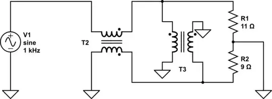

You're right T3 isn't ideally necessary, but it serves to keep things balanced despite variation in components. Consider a simplified case where the load is just a pair of 10 ohm resistors that might vary by +/- 10%:
schematic
T2 (ideally) requires that the current is equal in each of the windings, but since the resistors are not equal, the voltages across the resistors are not equal. The addition of T3 remedies the situation: in the common mode it appears as a short to ground. Thus, at the right side of T2 there will always be equal but opposite currents and voltages. Or as the author puts it, T3 "ensures that the load presented to T2 is balanced".

  • That's exactly what I was looking for Phil. Thankyou! Just to clarify, in the final paragraph when you refer to common-mode I take it you mean any part of the signal that isn't balanced or anti-phase? So, currents flowing against each other (as they would in anti-phase signals) present a high impedance, whereas other (imbalanced) parts of the signal are simply shunted to ground. Have I got that right? – Buck8pe Sep 11 '18 at 21:59
  • @Buck8pe Sounds like you have the right idea. For circuits like this, it can be useful to think not of "what's going on in the top / what's going on in the bottom" but rather "what's going on with equal but opposite things / what's going on when the things are equal in both sides". For a linear circuit, you can break things down either way an analyze them separately, and then add them together to get the full picture. – Phil Frost - W8II Sep 11 '18 at 22:05
  • That's spectacular Phil, I must have spent 2 days spinning my wheels looking at sims and wondering "why" it worked. That common mode comment has finally clinched it for me (and I can rest!) – Buck8pe Sep 11 '18 at 22:08
