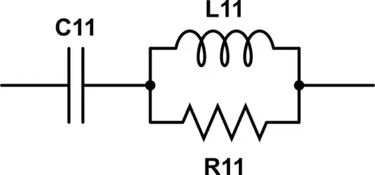

In David Leeson's (W6NL) Nov/Dec 2018 QEX article, "The Story of the Broadband Dipole," he cites the work of Tang, et al, on the "Equivalent Circuit of a Dipole Antenna Using Frequency-indpendent Lumped Elements." (from IEEE Transactions on Antennas and Propagation, Vol 41, No. 1, Jan 1993, pp. 100-103).
Leeson recommends this schematic equivalent as an adequate representation for a center-fed dipole:
schematic
simulate this circuit – Schematic created using CircuitLab
with: $h$ as the dipole half-length and $a$ as the wire radius, both in meters, $\omega_0$ as the resonant frequency in Hz and $R_{a0}$ the radiation resistance at resonance in ohms:
$$C_{11} = \frac{27.82\mathsf x 10^{-12} h}{ln(2h/a)-1.693}$$ $$L_{11} = \frac{1}{\omega_0^2C_{11}}+C_{11}R_{a0}^2$$ $$R_{11} = \frac{L_{11}}{C_{11}R_{a0}}$$

  • Interesting — is there a way to predict the radiation resistance (Ra0) term? That seems like a crucial missing piece to pure "back of envelope" estimation. – natevw - AF7TB Oct 18 '18 at 16:54
  • This [Dipole Antenna Calculator](http://www.rfwireless-world.com/calculators/Dipole-Antenna-Calculator.html) computes Ra0 in free space and gives the supporting equations. An example of the [Feed impedance variation of a dipole against height above ground](https://www.electronics-notes.com/articles/antennas-propagation/dipole-antenna/dipole-feed-matching.php) makes assumptions about the characteristics of the ground, which can strongly influence the results. – Brian K1LI Oct 20 '18 at 12:57
