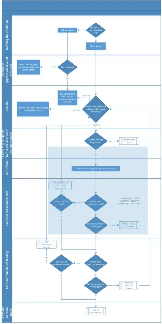

For dipoles already tuned to the proper frequency, I would answer "they do not need it". For other cases... it gets difficult to describe so please see the flow chart below.
dipole decision tree
Summary: Best case would be a full size, half-wavelength, tuned dipole. But if there is a wire length restriction for whatever reason, adding a set of "cap hats" is truly a no-brainer.

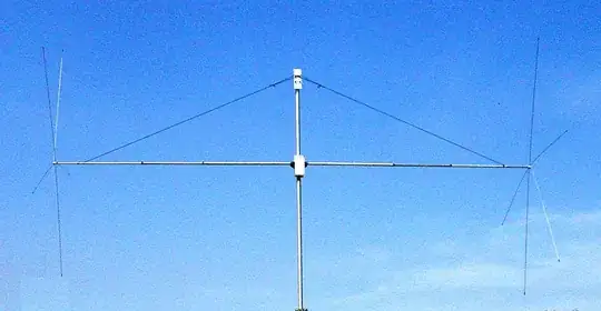

The concept of capacity hats on dipoles is not new. Here is a picture of a commercial dipole from DX Engineering. Note the clearly visible wire hats:

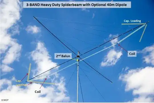

Here is a photo from DJ0IP showing his 40 meter cap hat dipole below his spider beam:

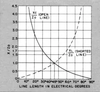

The classic modeling approach is to treat the antenna (or in the case of a dipole, each leg) as an open ended transmission line in order to calculate the impedance magnitude of the antenna (or the leg). The degree of wavelength of the antenna (or leg) is also computed. These values allow the reactance that is required to make up the "missing degrees" of the antenna element. Finally, the capacitive reactance required in the capacitance hat is computed. The following universal reactance curve for an open or shorted transmission line is used to compute the reactance required based on the missing degrees:
source: QST, September 1978, Designing a Vertical Antenna by Walter Schulz K3OQF
Inspection of the above diagram shows that if the element is a full 90° (1/4 wavelength) in length, then the transmission line effect will transform the infinite impedance of the open end to a near zero impedance (with near zero reactance) on the opposite end. For any electrical length in-between, the ratio of capacitive reactance to impedance is depicted. If the antenna is of simple wire construction, an impedance calculator such as https://chemandy.com/calculators/round-wire-impedance-calculator.htm may prove sufficient to determine the initial impedance magnitude of the wire. The commonly used formula for calculating impedance magnitude is:
