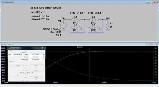

T1 in the "power amp" schematic you provided is a 4:1 step down transformer. Its purpose is to match - that is, maximize power transfer between - the preceding stage and the power amp transistors, whose high impedance is "swamped" by the 10-ohm resistors.
You can match the ~260-ohm driver to the PA by replacing T1 with a 16:1 step down transformer and replacing the 10-ohm resistors with 15-ohm resistors. You might find it simplest to accomplish the higher step down ratio by adding a second "copy" of T1 between the input and T2. Simulation indicates that an inductance of 1-uH should suffice for each of the four windings on T1a and T1b:

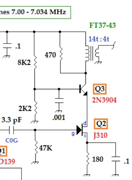

(most) of the circuit designs documented are characterized with a source or load impedance of 50 ohms.
True, but not important. In order to match impedence, the output impedance of the previous stage should match the input impedance of the next stage. That's all you need. Using bipolar transistors, for example, the output impedance is approximately equal to the collector resistor. The input impedance is roughly equal to beta times the emitter resistor, if not bypassed.
building a RF buffer-amplifier chain for a VFO
Therefore, if building a buffer, you don't need to match impedances, but just to lightly load the oscillator. Just the opposite of matching.
