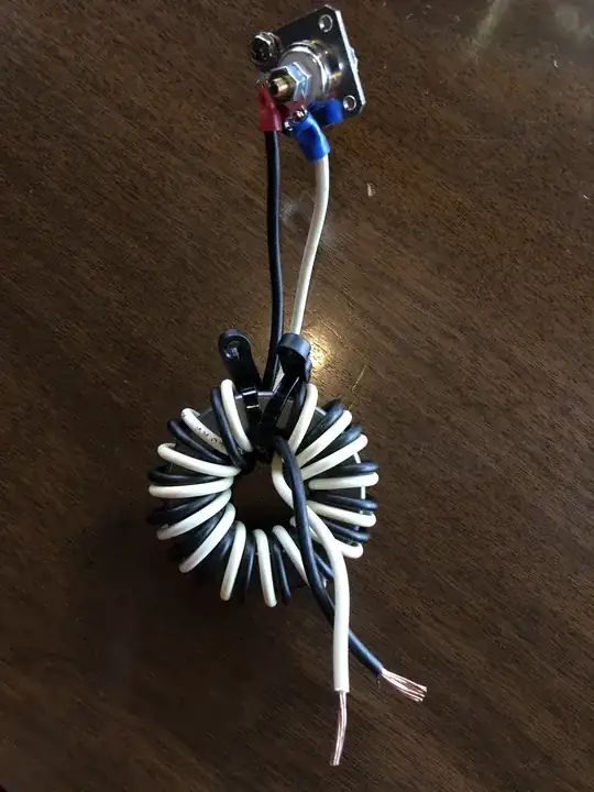

I've also tried a Bifilar choke as detailed in a presentation PDF from K9YC again starting on page 45 here https://www.qsl.net/w/wa3mej//Articles/K9YC/CoaxChokesPPT.pdf I have a picture of the one I've made...
My Bifilar Choke wound with #14 THHN wire
This was done with #14 THHN wire as detailed in the presentation above on page 47. This was connected to my feed-line on one end and the other end went straight into my flex-3000.

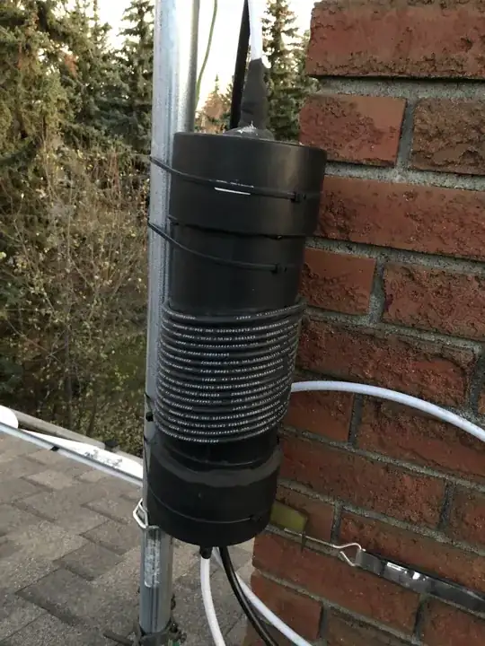

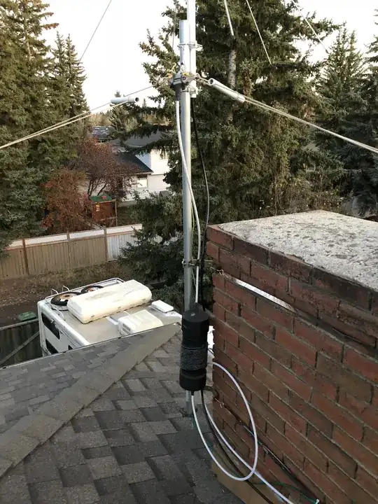

Here's some pictures of my antenna setup and my ugly balun. Obviously the height of the antenna is not ideal but this is up on the second floor. I've since added a vertical dipole (Comet 250B) which is not shown. As you can see the balun has coax seal all over it so I'll have to pull all that off and switch out the balun for my ferrite choke. I notice in the pictures that the coax seems to be drooping on my balun which I didn't notice earlier. Could this also be a factor?

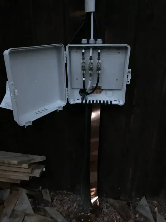

I've also included a picture of my new ground setup...
Antenna Setup Antenna Setup
Ugly Balun Ugly Balun
New Ground Setup New Ground Setup

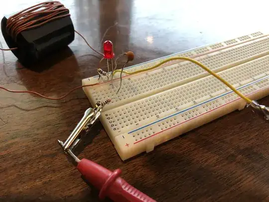

I've tried to make a quick and dirty version of the RFI detector that Phil Frost - W8II has pointed out. This is based not he link provided in the first answer below.
Here's a couple of pictures of my detector. It include the snap on ferrite with 10 turns of wire through into a breadboard where I just plugged in the components for now. I'm using a 101 nf cap (I assume that it is nF as there is only the number on it) and a 47 Ω and 100 Ω resistor. You'll see a red LED. I don't have any diodes handy at the moment but have them on order. I thought I would try the LED to see if it would work.

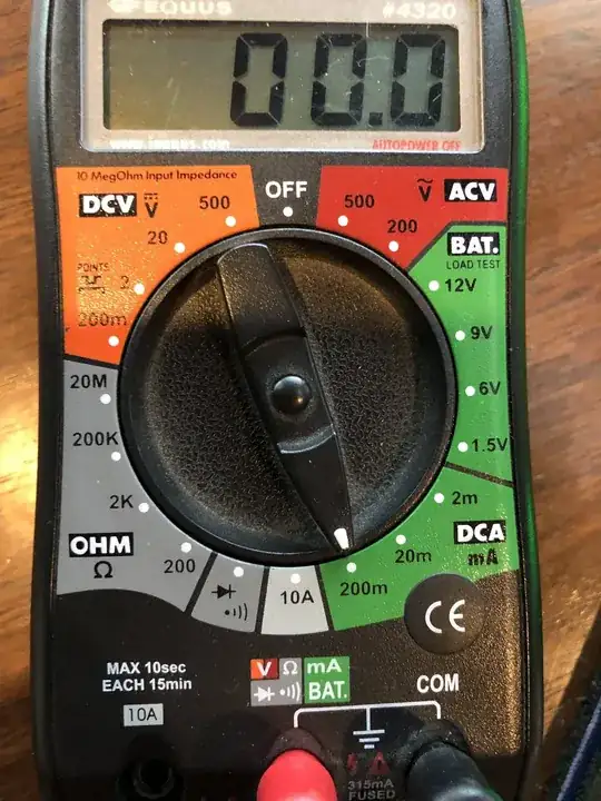

Unfortunately I don't get any reading on my multimeter. I have it set to 200mA and I put the ferrite beside my feed line. It just reads 00.0 all the time when I transmit. I'm not sure if that's good as I don't have any common mode current, or more likely I've done the detector wrong.
Here is a picture of my detector and my multimeter.
Detector Detector
Multimeter Multimeter

    The CMC detector outputs a voltage proportional to the CM current which gets rectified by the diode and stored on the capacitor. Set your meter to DC voltage. – Cecil - W5DXP Nov 18 '18 at 17:18
  • The coax feedline you're probing needs to go _through_ the core, not next to it. The ferrite core is a closed magnetic circuit, external magnetic fields won't induce a circulating magnetic flux in the core. – tomnexus Nov 18 '18 at 20:18
  • Thank you. I realized that yesterday after I posted my update. I've clamped it to my feed line and set the multimeter to 2 V. It always reads around 0.003 and 0.002 regardless if I'm transmitting or not and regardless of the power. – Etep - VE6ETP Nov 18 '18 at 20:45
That does look like a fine core to use, and the photo of your construction looks good. Your coax isn't causing any problems with noise.
Try putting the choke at the feedpoint, not at the radio, in lieu of the ugly balun you have now. A choke at the radio will do little since the coax shield, connector, and enclosure of the radio already form a continuous shield around all the receiving circuitry.

Ugly baluns can be ineffective. Since they are a purely reactive impedance they can't dissipate noise power, only redirect it. In some cases the reactance of the ugly balun combines with the common-mode reactance of the feedline or tower to make a resonant circuit which is worse than no balun. A properly selected ferrite on the other hand has a significant resistive component to its impedance, and thus works in all cases as it can convert noise power to heat.

    Phil's statement that, "Ugly baluns can be ineffective" is very true. One reason is that they are narrow-banded. The pictured ugly balun is probably effective on 20m and "ineffective" on 80m. Hardly any ugly balun is effective on 80m because we would need 60+ turns and then it probably wouldn't be effective on 20m because of self-resonant effects. – Cecil - W5DXP Nov 17 '18 at 18:07
