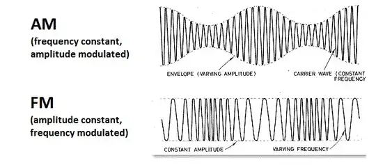

Amplitude modulation uses the modulation of the amplitude of a carrier wave to transmit data while leaving the carrier frequency constant, and in the case of FM it's just the other way round.
Why is a modulation of the frequency in an AM signal not used to transmit additional information, e.g. two audio channels or RDS information?

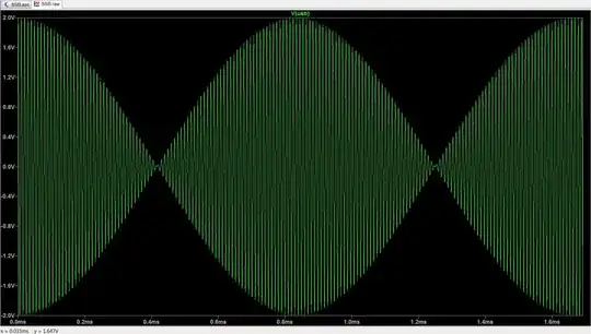

It turns out that we DO simultaneously use frequency and amplitude modulation: our everyday term for this is "single sideband." As described on Wikipedia, single-sideband is a special case of quadrature modulation in which the quadrature component (Q) is derived directly from the in-phase component (I) of the modulating signal.
This effect becomes evident upon examination of the waveform of an SSB signal produced by modulating tones of 700Hz and 1900Hz: enter image description here
Note that the period of the envelope is 833$\mu$s, a frequency of 1200Hz, which is the difference between the frequencies of the two modulating tones. At the "cusp" of the waveform, it experiences a 180-degree phase reversal, whose accurate reproduction is essential to a clean output. The mathematical combination of these amplitude and phase modulation components produces the two tones that are offset from the frequency of the carrier wave.

  • @OscarBravo Not a problem; I picked the image because it clearly shows that in AM, the frequency stays constant, while in FM the amplitude is constant - the specific frequencies were not the issue and I see how it is confusing. Thanks for the input, I removed and edited the image to clarify the important information. About FM - as I understood, noise affects mainly the amplitude of a received signal. FM allows to simply cut off the incoming amplitude below the noise (since it doesn't carry information), so the noise filter is just simpler in FM than in AM. – DK2AX Oct 29 '18 at 16:23
