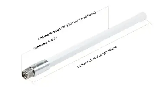

I have designed a LoRaWAN gateway and it is under testing. I have been using omnidirectional 3dBi dipole antenna FRP (Fibre-glass Epoxy Antenna) for 868 MHz.
Below is the picture of my antenna (please ignore the specification in the picture): enter image description here
I want to know how to calculate height required for getting a particular range. What would be minimum and maximum height for my setup? And what factors limit the height of the LoRaWAN antenna?
I have been reading about Fresnel Zone and understand that any obstacle in the zone will limit the range and solution would be to increase the height of the antenna or the end node. However, since I don't have much knowledge with the antennas, I think i might be missing concepts like fresnel zone. Please help me.
