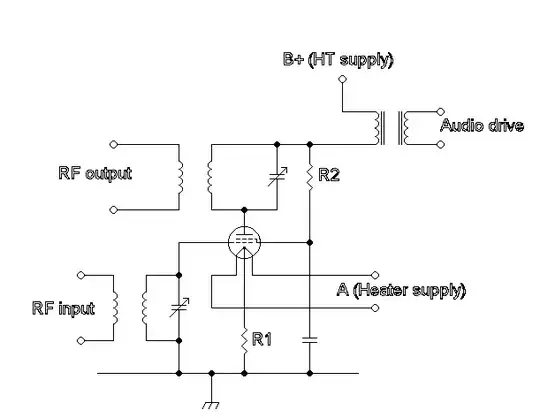

Trying to feed an SSB (or AM) signal to the gate or grid of a Class C amplifier will only produce an output on SSB peaks, which severely distorts the signal. And at the same time, out-of-band products ("splatter") is produced.
A Class C amplifier should only be gate- or grid-driven by a signal whose amplitude does not vary, such as FM. In AM, it is only amplifying the carrier signal.
In AM, the Class C output stage is always run at a constant power level and the audio modulation is commonly applied to the anode (or drain), never the gate or grid. The RF drive is constant, and the grid is biased several times the cutoff bias, which significantly increases its efficiency (over 30% as compared to a linear amplifier).
The modulated output signal has voltage levels at or near zero only as a result of applying the audio to the anode. A Class-C amplifier is only for amplifying the unmodulated carrier. It never should be used to amplify an AM signal.
From the Wikipedia article on AM:
In a class-C amplifier, less than 50% of the input signal is used (conduction angle Θ < 180°). Distortion is high.
Anode (plate) modulation. A tetrode's plate and screen grid voltage is modulated via an audio transformer. The resistor R1 sets the grid bias; both the input and output are tuned circuits with inductive coupling.
High level AM plate modulation in a Class C amplifier
This is a vacuum-tube tetrode, but the very same principle applies to a triode or any solid-state class-C amplifier.
