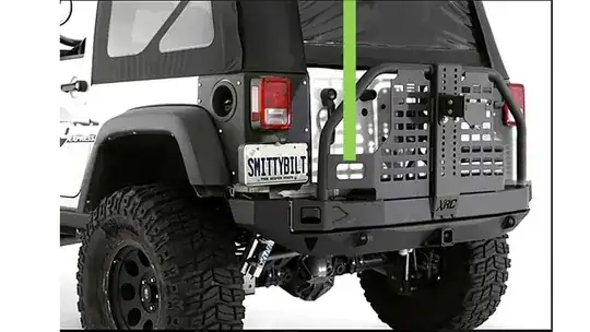

This antenna will be mounted on a tailgate / tire rack, and while there is some room for radials or a sheet of metal for a ground plane or radial, there isn't much more than a foot or so, possibly less. Some directions will have more room than others: the back moreso than in between the tailgates, for example.

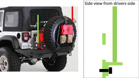

I don't want you to get distracted with my particular mounting setup, but here's where I'm planning on mounting it, which is a Smittybilt Atlas bumper and tire carrier. Jeep images are random from a DDG search. There will be some kind of interference with the tire carrier top tube, but I was hoping to mitigate that with a good ground plane. I will cover the tube with some kind of non-conductive material in case the antenna ever makes contact there while I am transmitting.
NOTE: The black part is a bolt. The Antenna is mounted on a small piece of angle iron in an L shape. My first idea was to put a piece of sheet metal as a ground plane perpendicular to the antenna, but when I started looking into ground planes, realized that often they use radials instead.

Based on the diagram that you added, a radial (wire) radial system will work for your installation. You will have some issues with directivity due to the metal in the tailgate. It would be better if you could elevate the base of the antenna so that it is even with the lower edge of the rear glass. The roll bar will still interfere with the pattern but it will be better in general.
On my Jeep (YJ Wrangler) I use a lip mount bracket on the front hood positioned on the opposite side of the AM/FM broadcast antenna. The hood and front quarter panel provide a reasonable, albeit asymmetric, ground plane.
