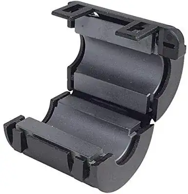

Since you are working with existing wiring, the easiest form of ferrite suppression is the clamp on variety:
You will need to acquire an assortment of type 31 and type 75 ferrite clamp on beads (don't use uncharacterized, junk box beads). The type 75 material is most effective at low HF frequencies while the type 31 material covers the balance of the HF and low VHF spectrum. Place at least one of each type of bead on all well insulated wires, as close as safely possible to where they enter and exit the inverter and any optimizers. Do not place beads on bare wires or in locations where they can come in contact live conductors such as screw terminals. Don't overlook control and network cables. Multiples of each bead per wire will increase the RFI suppression effectiveness. If you can wrap more than one turn of wire through the snap on core, its effectiveness is generally multiplied by the square of the turns. For example, 3 turns is the equivalent of 9 beads.

Note that clip-on ferrite chokes won't do anything to cure solar panel inverter noise.
