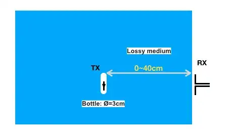

Scenario 1
  • TX antenna sealed in a small bottle (diameter 3 cm, length 10 cm)
  • TX antenna moving inside 50 L of a tissue-simulating liquid (held in a basin);
  • RX antenna fixed outside of the basin;
  • Both are connected to a Network Analyzer (very old, but calibrated before each measurement) that recorded the S parameters of different TX-RX distances;
  • Addition: The coaxial cables seemed to be very sensitive. A gentle twist could result in big changes in the S-parameters' curves in the frequency domain.
Scenario 2
  • TX antenna integrated to an electronic system (MCU+RF module+battery)
  • The whole electronic system was sealed in the small bottle (diameter 3 cm, length 10 cm), placed inside the aforementioned basin, and moved along the same trail as in Scenario 1;
  • RX antenna fixed outside of the basin and connected to a Spectrum Analyzer that recorded the received signal level at the same TX-RX separation distances as in Scenario 1;
  • S21 is regarded as Tranmitter power level - Received signal level - cable loss;
Illustration of the setup

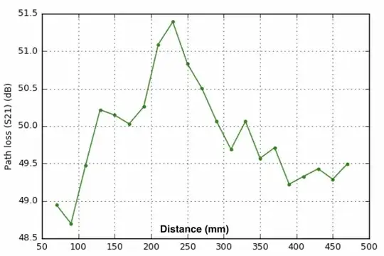

Scenario 1: S21 against distance fluctuated within a small range (the measurement was repeated many times) enter image description here
S11 against frequency and S22 against frequency were normal reflection curves, and the values were reasonable.

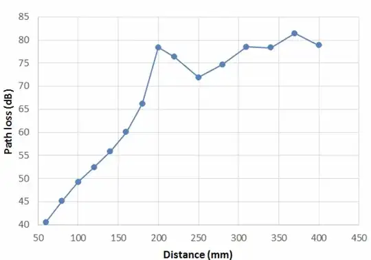

Scenario 2: S21 increased with TX-RX distance enter image description here

I would suspect that the primary reason for the seemingly odd results is that you are likely operating the experiment in the near field of the antennas. As your distance changes, the mutual coupling of the antennas changes.
As mutual coupling changes, antenna efficiencies, impedances, S11 and S22 parameters will change as well. You can execute experiments to confirm these effects. The result of this, however, is that your experiment has not isolated path loss but in fact has commingled other factors in the S21 measurement.
If you execute the test with at least 1 wavelength (i.e. > 0.7 meters) between the antennas, you should see more predictable results.
Given the lab environment, some of the observations could also be due to reflections of RF from nearby objects.
You will also need to take care that your transmission lines do not carry common mode currents as this will negatively impact the results. 1:1 choking baluns, or continuous ferrite sleeves consisting of the appropriate material, on double shielded coax is recommended.
As far as the effect of the lossy medium goes, the effect can be modeled as a loss within the transmitting antenna system as long as the medium is a homogeneous, non conducting medium (e.g. a dielectric). Thus the path loss, once outside of the medium and in the far fields of the antenna, will follow a classic free space path loss (FSPL) model.
Glenn W9IQ

  • A further question: why spectrum analyzer could give more reasonable results of PL against distance when similar environmental influences were captured by both VNA and SXA? – luw Jan 22 '19 at 15:24
  • @luw It would seem to be an instrument error or an application error. – Glenn W9IQ Jan 22 '19 at 17:17
  • But the S11 and S22 were measured reasonably. Could the instrument error only affect S12 and S21 measurement? – luw Jan 24 '19 at 09:21
