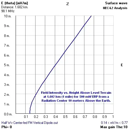

Considerations when comparing the field intensities from different transmit antennas over a given terrestrial path, and assuming use of the same receive+antenna system and its siting/adjustment for all measurements:
  • Path distance from transmit antenna to receive antenna
  • Height above the reflecting plane (Earth) of the radiation center of each transmit antenna
  • Free-space radiation pattern of each transmit antenna toward the receive antenna, in the vertical plane
The graphic below shows the variations in received field vs. elevation above a level ground plane, for the configuration and conditions stated in the graphic.
The vertical axis (Z) = Height above Earth of the calculated field.
The horizontal axis (E) = Field intensity in mV/m.
